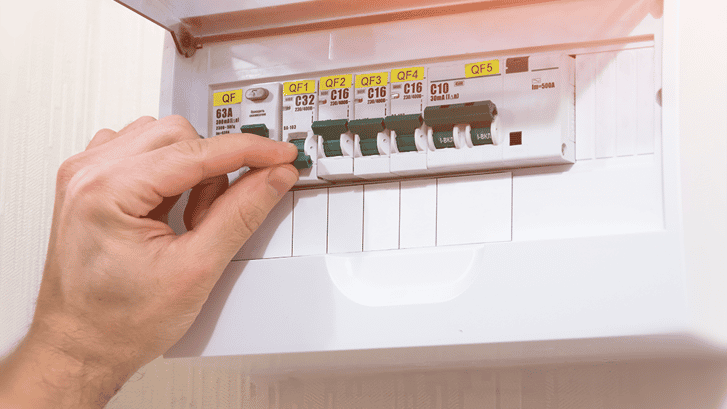

Starting off, verify that the home’s electrical panel is properly grounded, for safety reasons. Then check the overall condition of the panel, keeping local codes in mind. You may discover the panel is too outdated or damaged to work sufficiently and safely.
For example:
