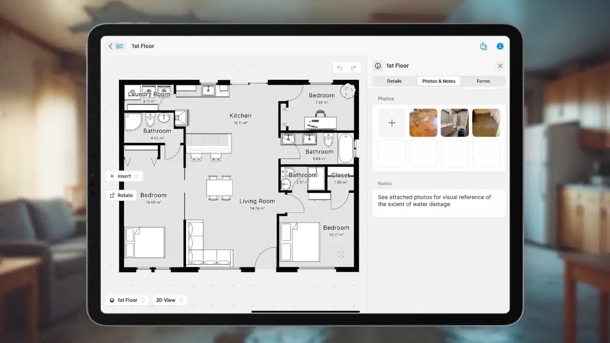

These visuals don’t just document the “what” — they also show the “where” and “how much.” And the best way to capture good visuals is with a digital tool like magicplan. The magicplan app make it easy to sketch each affected room, and then attach visuals to exact locations within the sketch. That way, nothing gets lost in translation. (It’s also faster and more intuitive than handwriting a scope sheet and having to draw rough sketches.)
And remember: While photo documentation is important, videos and 360-degree scans are equally helpful in making sure your estimator doesn’t miss a detail. Just make sure each video or scan is thorough and well-composed, to create trust and transparency between you and the estimator.
